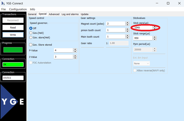

If you are sure that the Throttle signal duration goes to 1040us, then it is easy:
Just set the ESC's zero to 1040us:

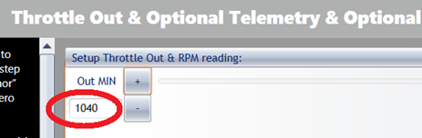

And the zero of the flight controller to 1040us:

I did this already, as soon as I've foud out about this issue.  It's a bandaid fix.
