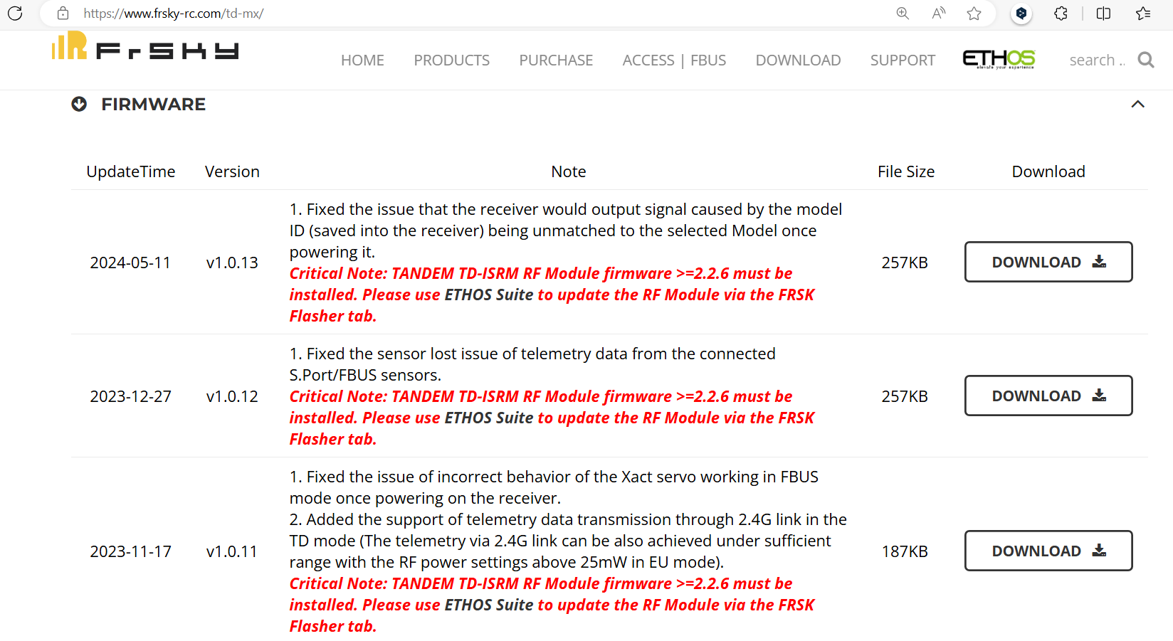

I ve got a problem withe the ethos integration of my brain 2. everything is up to date, the lua script works on my x-20 the brain is connected via FBUS to my td-mx reciever and I habe the telemetry data from the hobbywing esc. The problem is when I open the fcu app on my transmitter there are no values in the different menues. Does somebody have an idea where the problem lies?

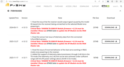

Have you updated your receiver firmware to the latest version FW-TDMX_1.0.13.frsk?
Are you using the latest version of ETHOS 1.5.11?
Have you updated the firmware of the TD-ISRM radio module of your transmitter to version 2.2.6?
After setting up the TD protocol in your transmitter and binding the receiver, did you switch the transmitter off and on again?
