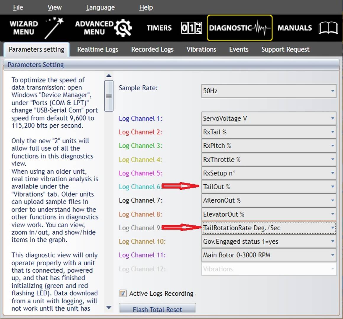

For a better diagnosis of the behaviour of the tail motor control, you should add other parameters related to the tail behaviour instead of the parameters you do not need for your specific problem.
From the tail rotation speed graph (TailRotationRate Deg./Sec parameter), you will be able to better understand if, with the ESC you are using, the output signal controlling the tail (TailOut%) should move earlier and faster or later and more gradually or should be kept more stable (or less stable).

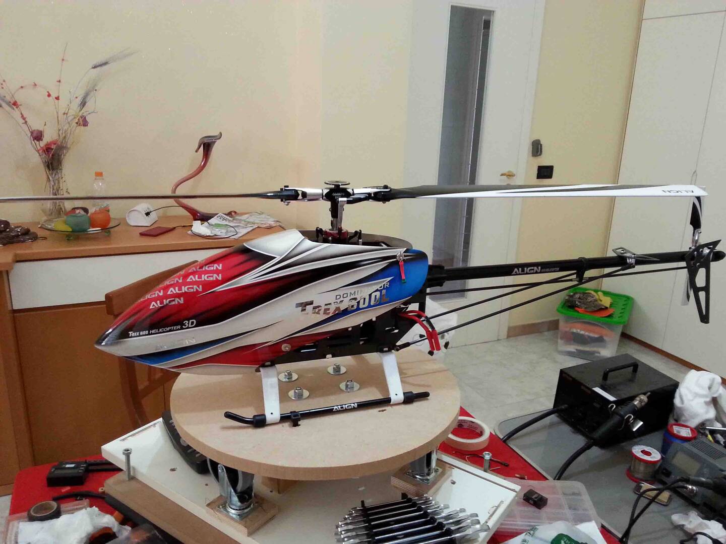

(@francesco-loco88)
Trusted Member Customer Registered
Posts: 60
i have created one plane rotatory that can only rotate, so the model he can not crash.
The first tail setup  you do it on the plane rotatory with pitch blade at 0 and the plane and the model well fixed.
And now you go the first setting brain tail
