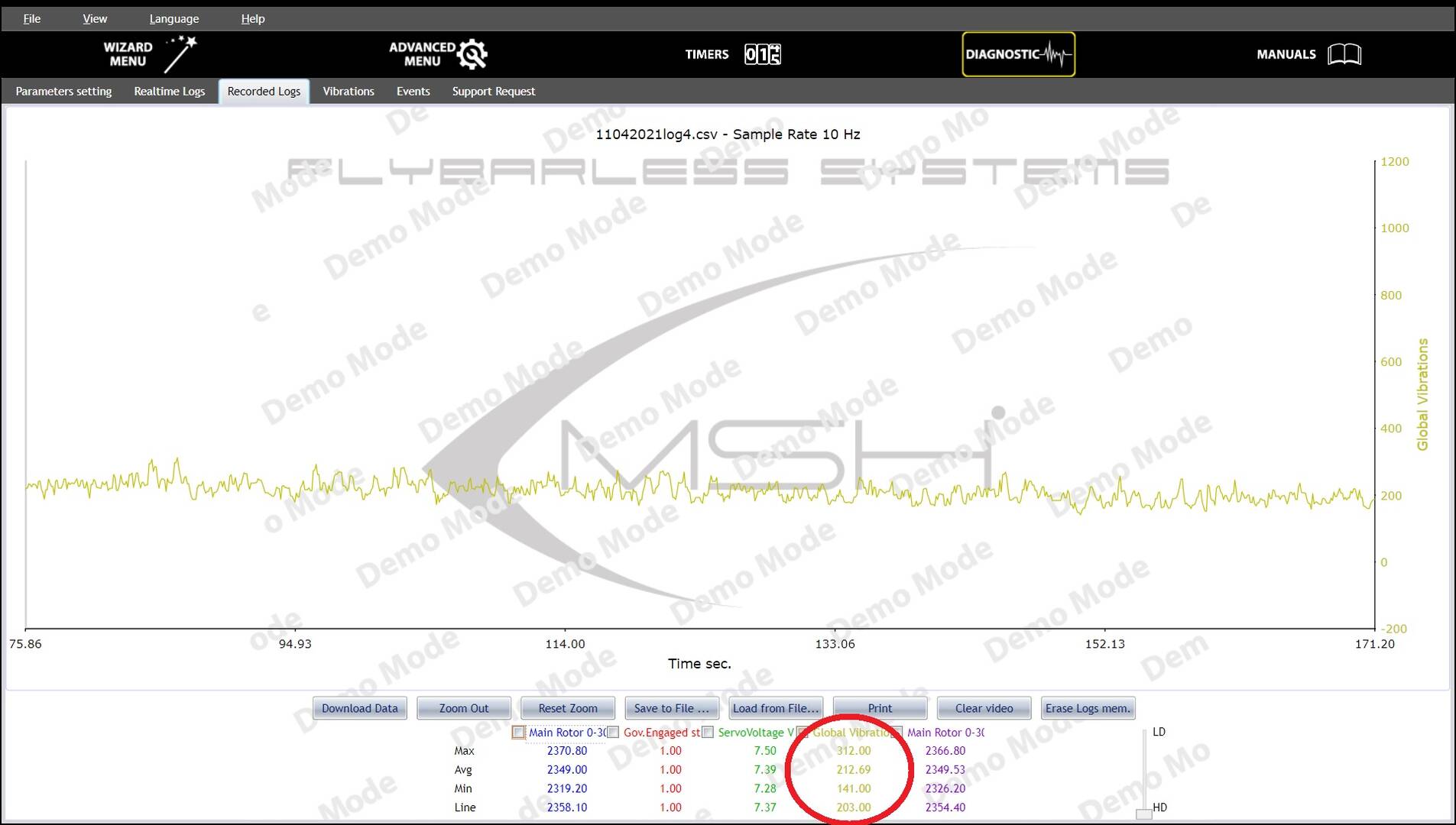

I'll show you my log vibration, You can help me?
What vibration value do to in tilt brain 2 BT?

I decrease vibration under 199.
I've always view log vibration in mode wrong.
I read the valor that i saw in the rectangle that i colored yellow
https://1drv.ms/u/s!AlKmGfxd3G4JonFbEeFYFy9BiQfG?e=JdMU8u
The vibration principal in log my fly attual is color red (head) and principal vibration axis x (left righ) the principal problem is blade main rotor?

I have controlled every minimal parts of my trex 600l dominator and i have lowered the vibration under 199.
Only sometimes exceeds 199 but for a short time.
The vibration now is under 199 but the problem with rescue remain.

You have already been answered on HeliFreak:
"To my eye/in my experience, your vibrations are still far too high at the low frequencies, regardless of what the global vibration number is. Have you tried re-mounting the Brain with some softer/thicker tape (or at least new tape?) The tape characteristics are one thing that could change over a long period of storage. Some good pictures showing the details of your installation might be helpful too."
You can then:
a) Reduce the low-frequency vibrations.
b) Move the control unit to another position.
c) Use a softer, more spongy double-sided tape (as you were told in the first answer on 3 April on RCDreams).
Although the new vibration graph has improved over the previous one, now that you have added the 'Global Vibrations' parameter to the parameters logged during the flights, by zooming in on the graph only the part of the flight and discarding also the major initial and final vibrations, you can see at the bottom of the maximum, average and minimum values that you still have an 'average' vibration value of 213 with values up to 312 without having made particularly violent and/or fast manoeuvres and therefore with a graph with no particular peaks.
GlobalVibrations

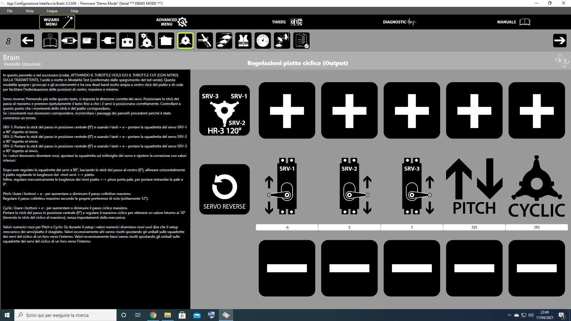

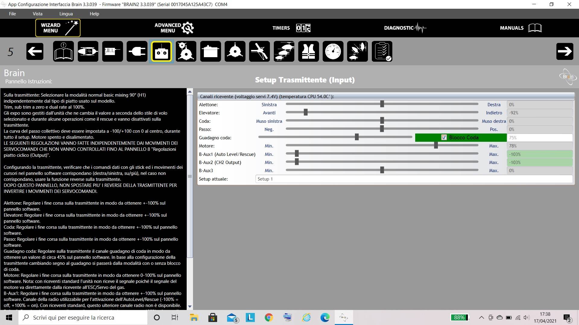

I want to get you noticed, when i resumed my model after a long time the movements of the servos they were reversed.
If i was going the pannel 5 of wizard the cursor of aileron and elevator it moved inverted.
This thing can be you helpful?
And my limit servos now they arrive max 90% with all limit radio is at max range.
Today i post you the screen

The commands arriving from the transmitter cannot in any way be reversed by the flight control unit (there is no routine that can reverse the incoming signals) but must be reversed in the transmitter.
If the commands coming from the transmitter and displayed in panel 5 are reversed, it means that they have been reversed in the transmitter setup or a different model has been loaded in the transmitter, or a model reset has been done in the transmitter, or firmware has been updated in the transmitter and the new firmware has changed the transmitter setup.
If the controls on panel 5 are reversed, the transmitter roll control and Auto Level roll control are in opposite directions of each other.
If the input controls shown on panel 5 are reversed, you can compensate for this setup error by reversing the output signals to the servos.
However, the auto level controls will operate incorrectly because the output commands to the servos will be reversed.
In short, the setup must be done correctly as explained in the instructions. It is not conceivable to think that if the setup is done backwards from what is indicated and expected, then everything will work correctly.
In the instructions, in the last panel of the wizard, it is explained to check the movement of the swashplate even with Auto Level on to make sure the swashplate moves correctly while remaining parallel to the ground. Has this been done?
However, if the Auto Level controls have been reversed because the output signals to the servos have been reversed, then activating Auto Level should cause the model to not only tilt but to completely tip over and crash to the ground. So from what has been written so far there is still something that does not match.
Regarding the 90% signal limit, have you tried increasing the dual rate value?

I saw the controls pre flight the pannel 14 and i saw which was not good and i have escape the crash of my model.
First all my comands they arrived at 100% in pannel 5.Dual rate i didn't touch it, but is at 100%.
The cable servo have not touched, in conclusion since it was good i have not change nothing.
I change only after have seen that there are problems.
The instructions of brain before have been executed to perfection.
(@francesco-loco88)
Trusted Member Customer Registered
Posts: 60
elev 90
0gradi
this is screen of my limit.
I have this limit also aileron, rudd.
However in this moment the pannel 8 in wizard mode, parameter cyclic 35% possibly that for tease reason my limit is max 90%.
pannel8
When i do settings for first time i had all setting as the manual brain says.
Radio with shasplate 90°, all curve pitch and motor 0-25-50-75-100 ecc ecc.
Now i go in the software with all parameter set for to fly.
Dual rate my radio is 100% (max) and limit servos in my radio (spektrum dx6i) name is travel adjust and standard parameter for all 2 direction servos is 100% and i have increased at max valor 125%.
When i have fact setting brain the first time i remember that the limit in pannel 5 they arrived at 100%.

a) we reiterate that it is a useless job and just a waste of time to download the flight file from both the Recorded Logs and Vibrations windows. The files downloaded from Recorded Logs and the files downloaded from Vibrations are identical (just compare the size) and contain the same data: both data logs and vibrations.
b) The low frequency vibrations, although reduced, are still high. These low frequency vibrations are more model 'wobble' than vibration and should be visible to the eye. They could be caused by many things, but could also be caused by too much gain for the type of blades used and the type of dampers used in the head (leaving the head dampers unused for a year or more may have hardened the rubber/plastic in the dampers and perhaps not been maintained by checking and lubricating them). I suggest you try reducing the P-values of elevator and aileron by a couple of points in Setup 2 and 4 points in Setup 3, then fly for a minute from Setup 1 to Setup 2 and then to Setup 3, and then check the low-frequency vibration amplitude (oscillations) in the fligt logs while Setup 1, 2 and 3 are active to see if reducing the P-values will reduce the oscillations in the model.

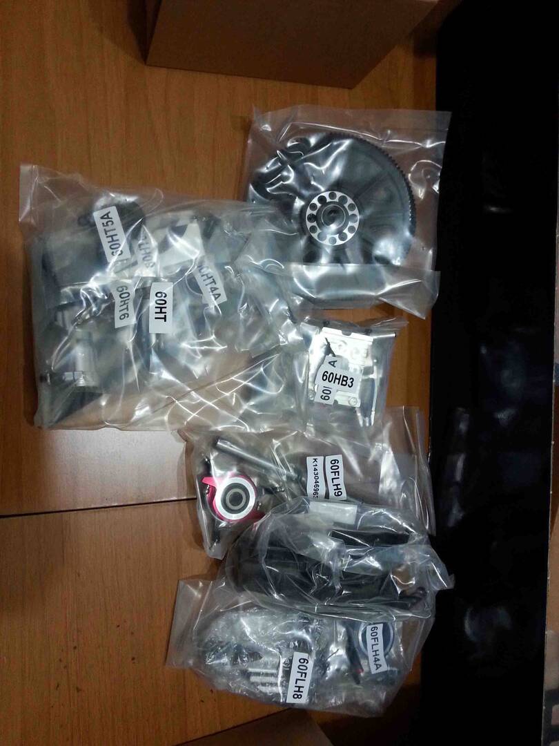

sure it's as you say this is photo when i buy my helicopter.
20150529 093918
20150529 093538
20150529 093239
20150529 192353
this photo have date 29/05/2015 today is 23/04/2021 and i search not to touch the model.
in date 30/12/2016 after many searches on internet, i saw one my friends with brain and i buy brain 2 bt, if i did not see my friends i would never seen brain.
IMG 20161230 135338
All my meccanic is new (and all original i haven't changed anything) but today dumper rubber it will have to be changed.
