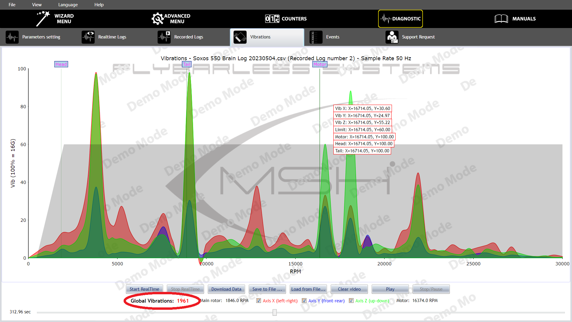

As a side note, if you haven't already seen it, we point out that the vibrations in your model are crazy, reaching almost 2000%.
We suggest you take action to prevent any contacts from slipping off in your model, screws from loosening, or screws from breaking while you are flying.

I will look further at the vibration issues.

However, you have to reduce the vibrations of your model because with such high vibrations you risk damaging the mechanics of your model. If you have already done a dozen or so flights, we suggest you check all the model's tightenings to make sure none have loosened.
