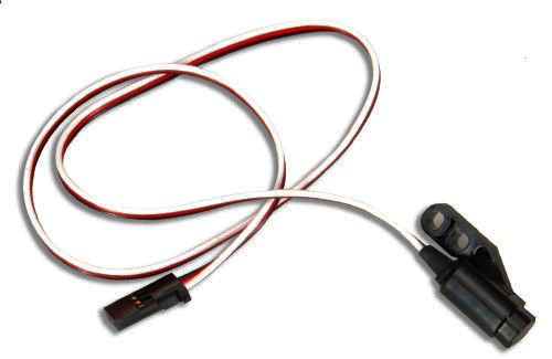

Hi,
I use Futaba RPM Sensor for nitro and it is connected to gov port in brain 2. Everything work perfectly I see the value of RPM in the Brain application. Is it possible to see this value as telemetry on the Futaba transmitter? I use Futaba 16IZ. Futaba receiver is connected with Brain via S.BUS2.
Thanks for help.
(@jacekszewczyk-eu)
 This is my RPM sensor.
In addition to what is explained in the manual for your Futaba transmitter, in the MANUALS section of our Windows, Android and iOS apps you will find among other PDF documents, the Telemetry document (or you can download it from the Downloads section of our website). In the table of contents on the first page you will find the section "Radio telemetry activation from Brain2/iKon2 to:", click on the brand of your transmitter (Futaba) and you will find all the information you need to be able to see the RPMs on your transmitter (paragraph 11, slot 28).
In the same document it is also explained on page 4 how to connect a temperature sensor to measure the engine temperature and figure out if the carburetion is too lean or too fat, and on page 8 how to display the value on the transmitter.
(@jacekszewczyk-eu)
Thanks All works perfectly. Sorry for the question this was only one option which I didn't try 🙂
