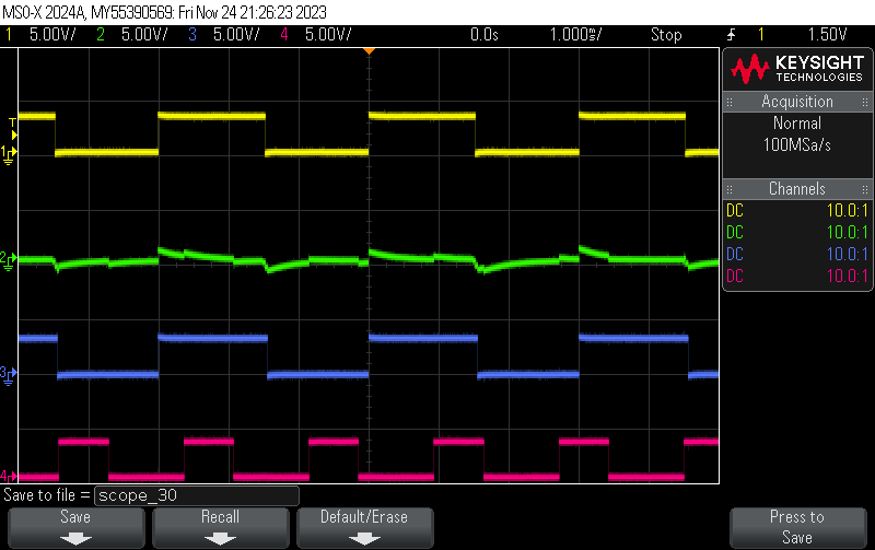

This is an oscilloscope picture of the failed Mini Brain 2:
scope 30 bad ch2 output
(yellow is CH1, green Ch2, blue Ch3, and red ch4)
The trace in green is the problem output. How can this output fail with just a firmware update?

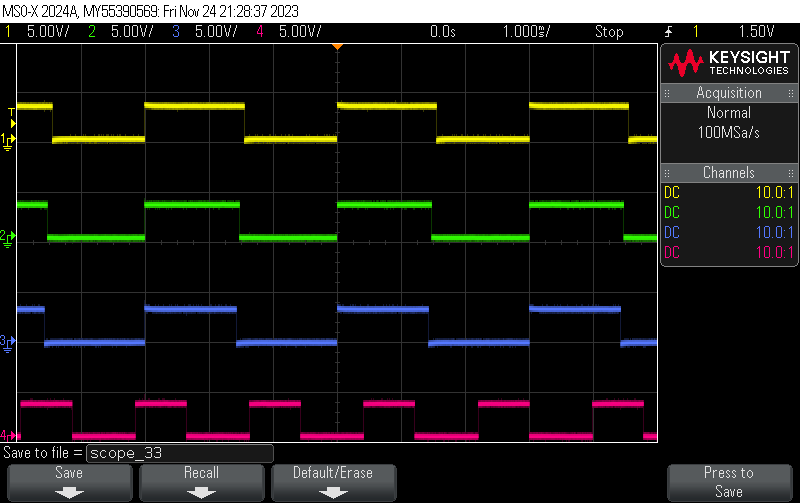

For reference, below is a trace from a working Mini Brain 2 from another helicopter:
scope 33 good outputs
