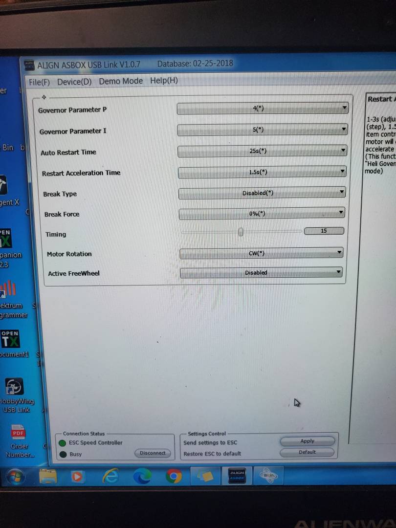

20210831 193315
Hi, on ikon I have startup at 1, but I want it more slower startup, would it be ok to get on esc programming card set auto start up from 25s to 10sec??
You can try this.
