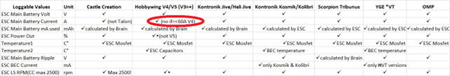

HobbyWing ESCs with power less than 80W do NOT have the current consumption sensor inside. Therefore, the current consumed cannot be measured either.
It should be clearly documented by Hobbywing, we have documented it in the telemetry table of the various ESC models found on page 2 of the telemetry PDF manual, which can be downloaded from the MANUALS section of the Windows, Android, iOS apps or downloaded from the Downloads section of our website:
As small ESCs that also have telemetry of current draw, Kontronik Kolibri 60A and YGE LVTs (35A & 65A) are currently available on the market. They also have a smaller size and lighter weight. However, they cost more than the HobbyWings.
Or the OMP 65A has just been introduced to the market.
