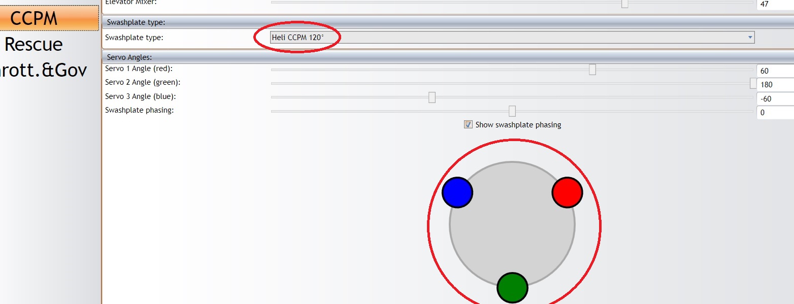

Your problem is due to a strange Swashplate setup.
If you go in to the Advanced section, "Common" tab, CCPM, you can see that the swashplate Type selected is "CCPM 120°" (and not the Reversed "CCPM R-120) but the setup of "Servo Angles" is for the reversed CCPM R-120.
WrongCCPM
This is a contradictory setup!
Please, go to panel 6 of the Wizard and click/select again the correct icon of the kind of swashplate used on your model, then you can return in Advanced and see if now all is correct.

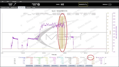

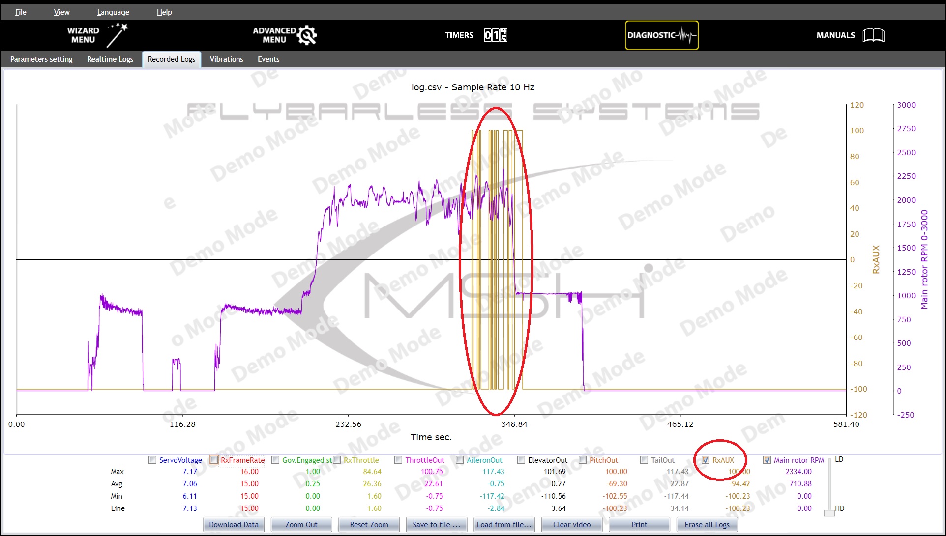

A question I forgot to ask:
Why was the AUX channel (AutoLevel / Rescue) activated so many times and repeatedly towards the end of the flight?

That part of the flight was the problematic part. Heli was behaving like it was given a full left command. I was trying to level the heli while looking for a place to land safely. Before that, the flight was very smooth.
