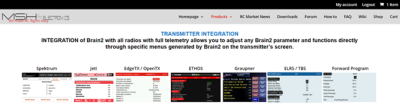

However, we feel it is useful and necessary to remind you that our flight controllers all have Integrations already included in the price and already active in the firmware. Through the Integrations you can view and change all the parameters of our flight controllers through special menus that our flight controllers display directly on the screens of all transmitters that have bidirectional telemetry: Spektrum, Jeti, Graupner, OpenTX, EdgeTX, ETHOS, ELRS, TBS.
In case you have not already seen it, we refer you to our website:
https://www.msh-electronics.com/products/#integrations
And to the related documentation in the Downloads section of our website.
