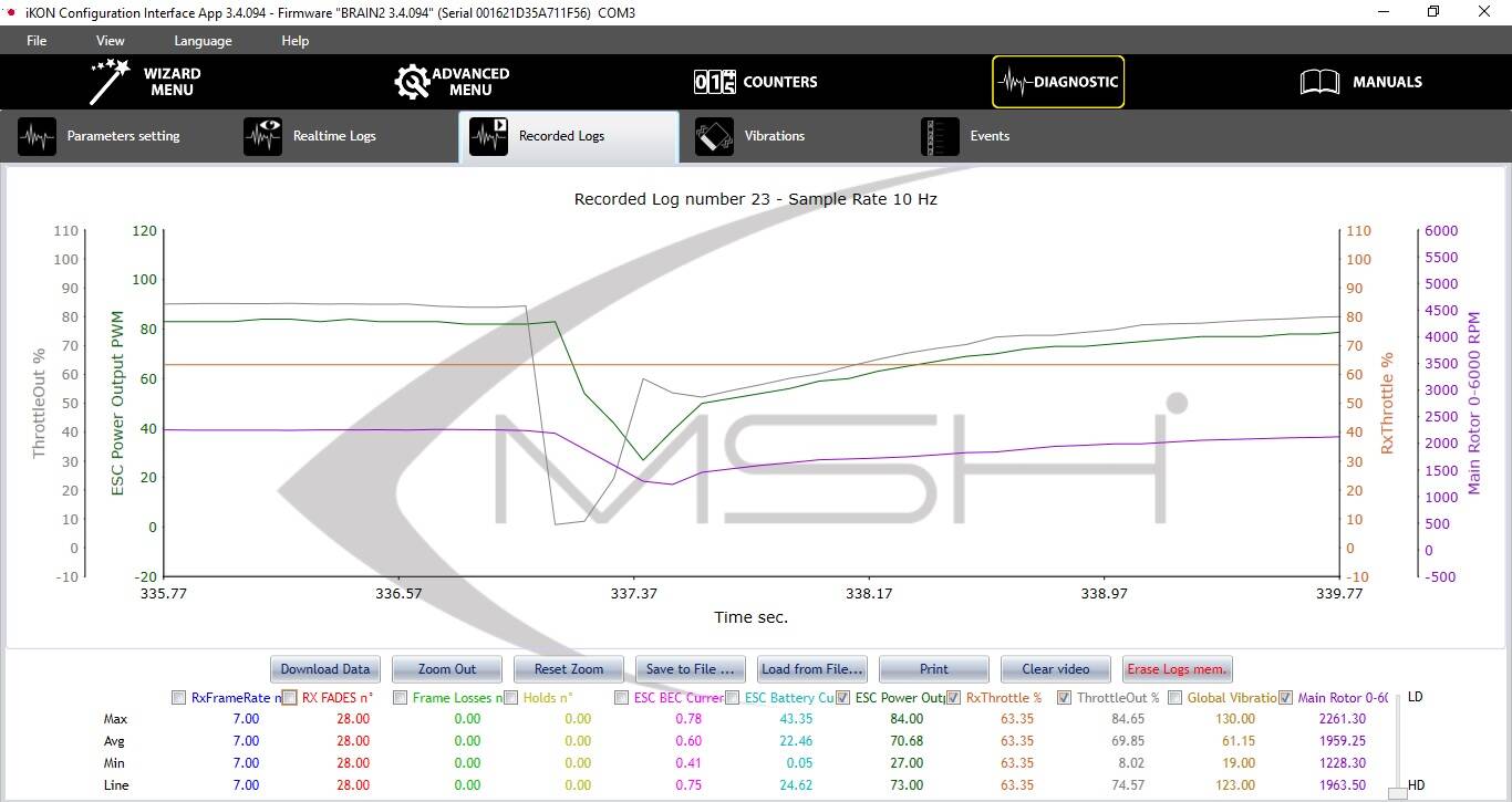

I'm clinging to the last mm of my iKon2 rope here. I thought we were good to go here, but nope. iKon2 decides to cut throttle for no reason & do other weird shit like saying gov disengaged & flight count increased while I'm happily flying along. There are points where I'm testing bailout & rescue here, but this ain't one of them.
Issue is at ~336 seconds of flight 23.
ESC telemetry was also terminated when the throttle blipped.
This isn't isolated but it is the first time I was logging throttle data.
Not the end of the world at 50 feet in a hover, but this could end VERY BADLY!

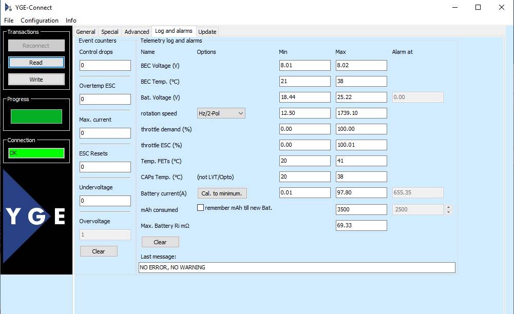

  • YGE Saphir 125A - reports zero issues

YGE ESC with no errors(that over volt has been there forever & this has never seen more than 6s):
screen grab yge after 1 flight after issue

Thank you for the report and the files.
We are sorry for the problem you are experiencing with your configuration with ESC YGE and all three dials active and that thanks to the files you sent us we should be able to solve.
From the Flight Log we see that there were two very short Throttle Cuts but without any loss of signals and model control.
Thanks to the Autorotation Bailout on, we see that the ThrottleOut signal is back to the correct value in a few moments.
The unidirectional bearing and flywheel effect of the main rotor should have caused the rotor RPMs to drop very little and the phenomenon was hardly felt during flight and if necessary, easily compensated with a very small change in the collective pitch.

PS: The incoming Throttle signal from your transmitter goes to -5%. We suggest you correct it in your transmitter by bringing the signal to 0% to avoid unnecessary delays in starting the motor caused by the fact that the spoolup ramp must gradually raise the signal from -5% to zero before starting to turn the motor.
Regarding your comment "flight count increased while I'm happily flying along," the Event is normal because, as explained in the instructions the flight count is increased after ten seconds from when the throttle has exceeded the value of 10%. The Events of "Governor disengaged" and "Governor engaged" are also normal when the Throttle goes to zero and then immediately returns to the previous value.

Yeah I'm using f.port now since I'm using the GPS on the R9M & whatever was going on causing integration to hang on me seems to have resolved itself.
To be 100% clear, the ONLY issue I saw/felt/heard was at ~336 seconds on the screenshot I've attached where the RxThrottle has remained constant but the throttle dropped on its own.
And I'm still a tail in guy working on orientations so it did freak me out! LOL
But at ~506 seconds I actually commanded the drop in throttle as I was testing out the autorotation bailout feature.
Which is what I've been trying to tune between the ESC & iKon2 to get a quick but smooth bailout.
Edit: For the events I mentioned it was all about where they were as the throttle drop wasn't commanded by me/radio. But it makes sense that they'd show up regardless of whether not the throttle cut/gov disengaged was commanded or not.  Not sure why I've associated the flight count with a spool down. So yeah, that really doesn't point to anything but I THOUGHT it would be a clue for you guys. Sorry about that. End edit.
VERY good catch on the throttle travel though! Not sure how that happened & correcting it will probably make it easier to tune soft start/gov/bailout. So THANK YOU for that!!!
But again, this was all about the iKon2 acting like I had dropped the throttle at ~336 seconds when I had not.
