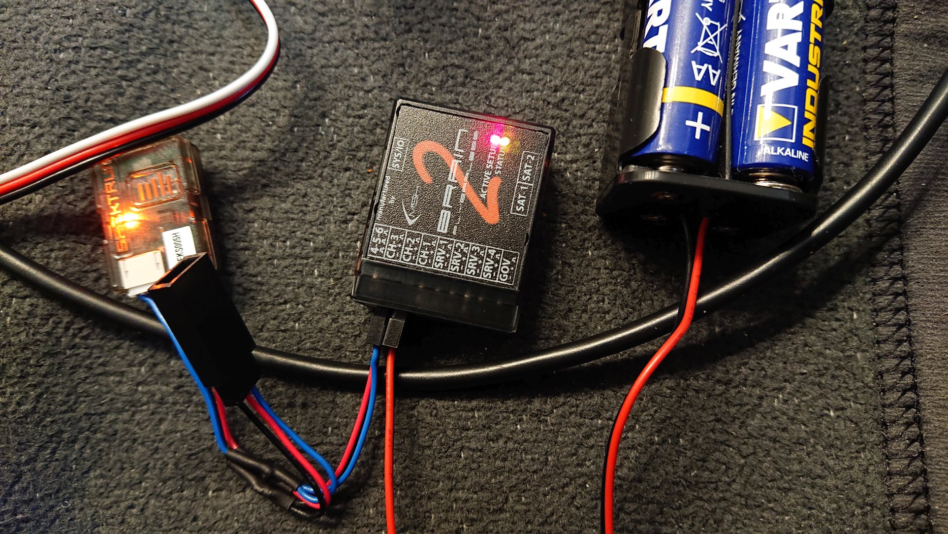

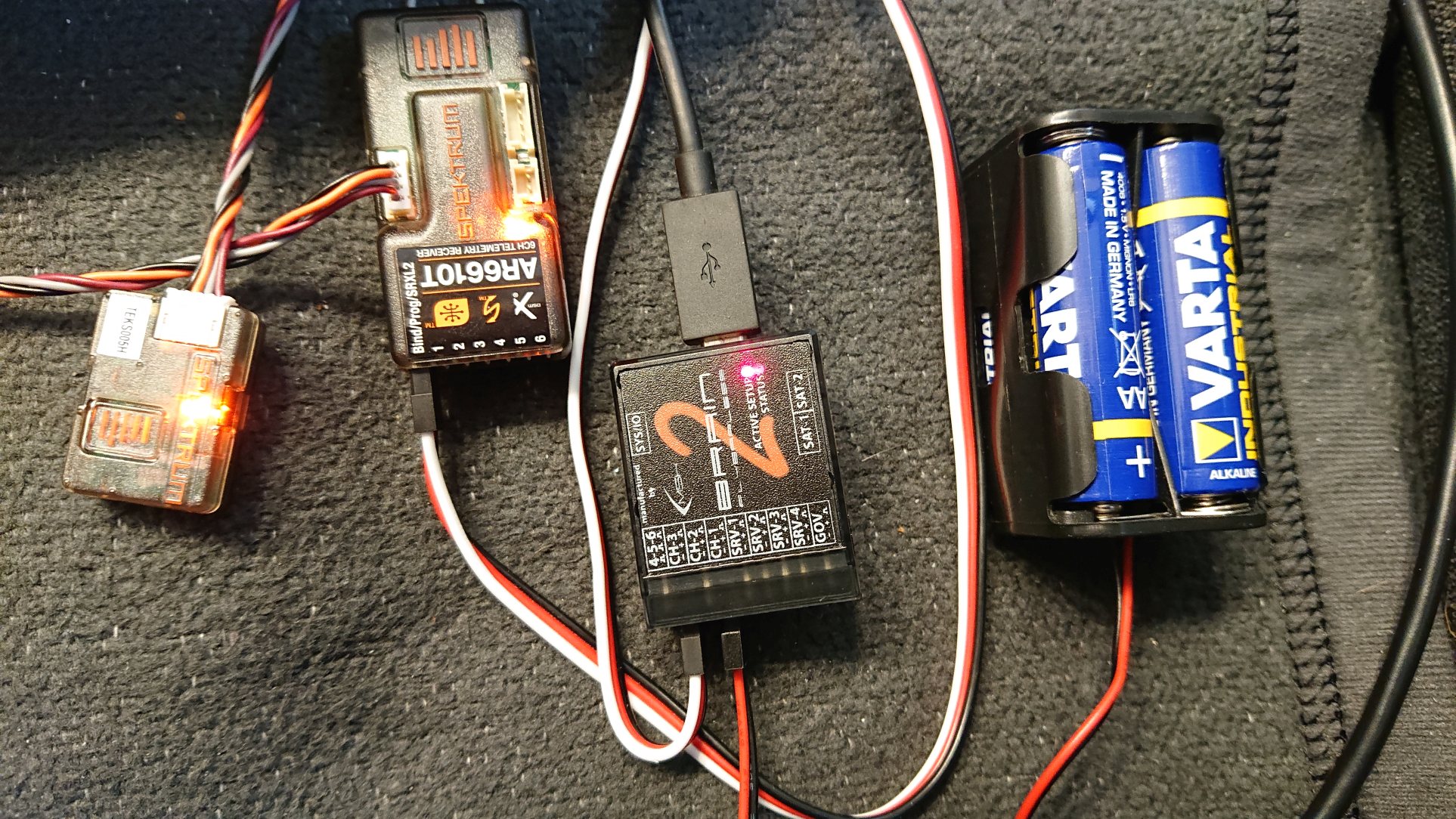

DSC 2009
First the receiver must be powered (MIN 4,7V, MAX 8,4V) from the servo bus of the Brain2 and in the picture we can't see any power cable connected to the servo bus of the Brain2.
Note: the USB cable will power the inside of the Flight Control Unit, but will not power the servo bus (servos, receivers, etc.). This is done because the USB ports of the PCs do not provide enough current to power the servos connected to the Brain2 Servo Bus.

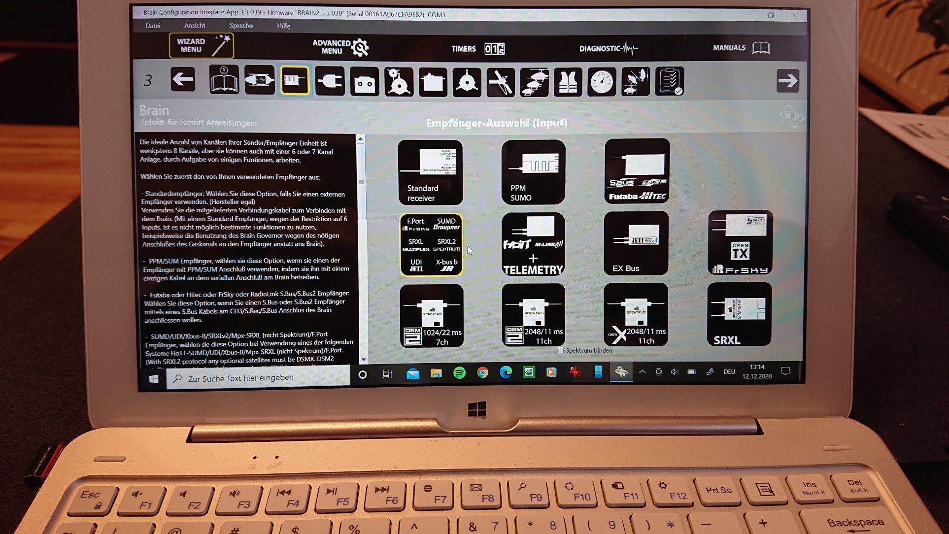

Second, using the apps (Window, Android, iOS) in the Receiver Selection panel of the Wizard, select the correct receiver type (SRXL2) which is the first icon on the left of the second row and not the last icon on the right of the third row (SRXL not "2").

If I use the Ar6610T without the SPM9746, I also get no connection to the brain. The Status LED remains dark
If I only use the SPM9747 receiver, the connection works and the status LED lights up green.
The same problem is also with a 7.8V BEC
DSC 2013
DSC 2010
DSC 2017
