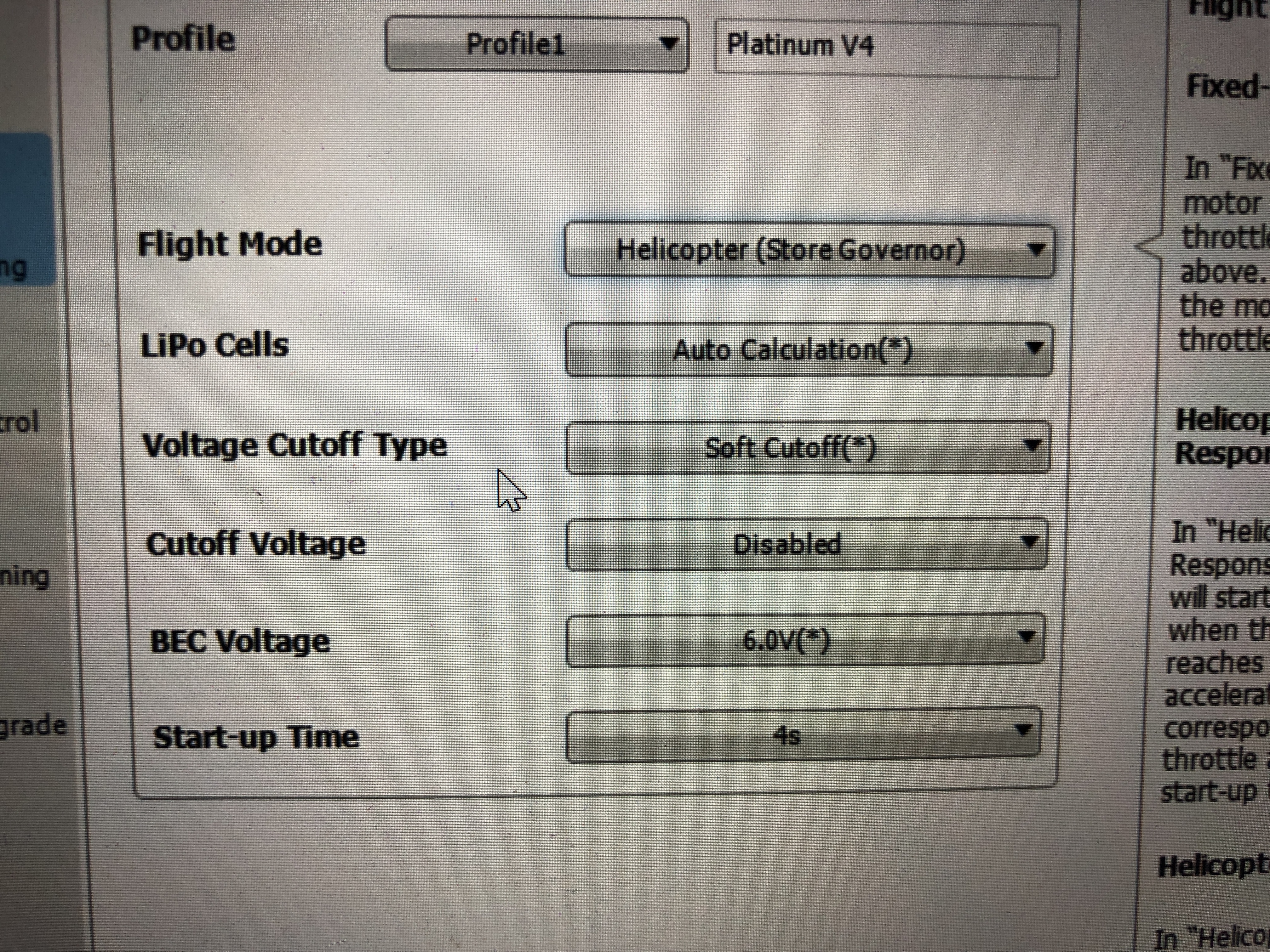

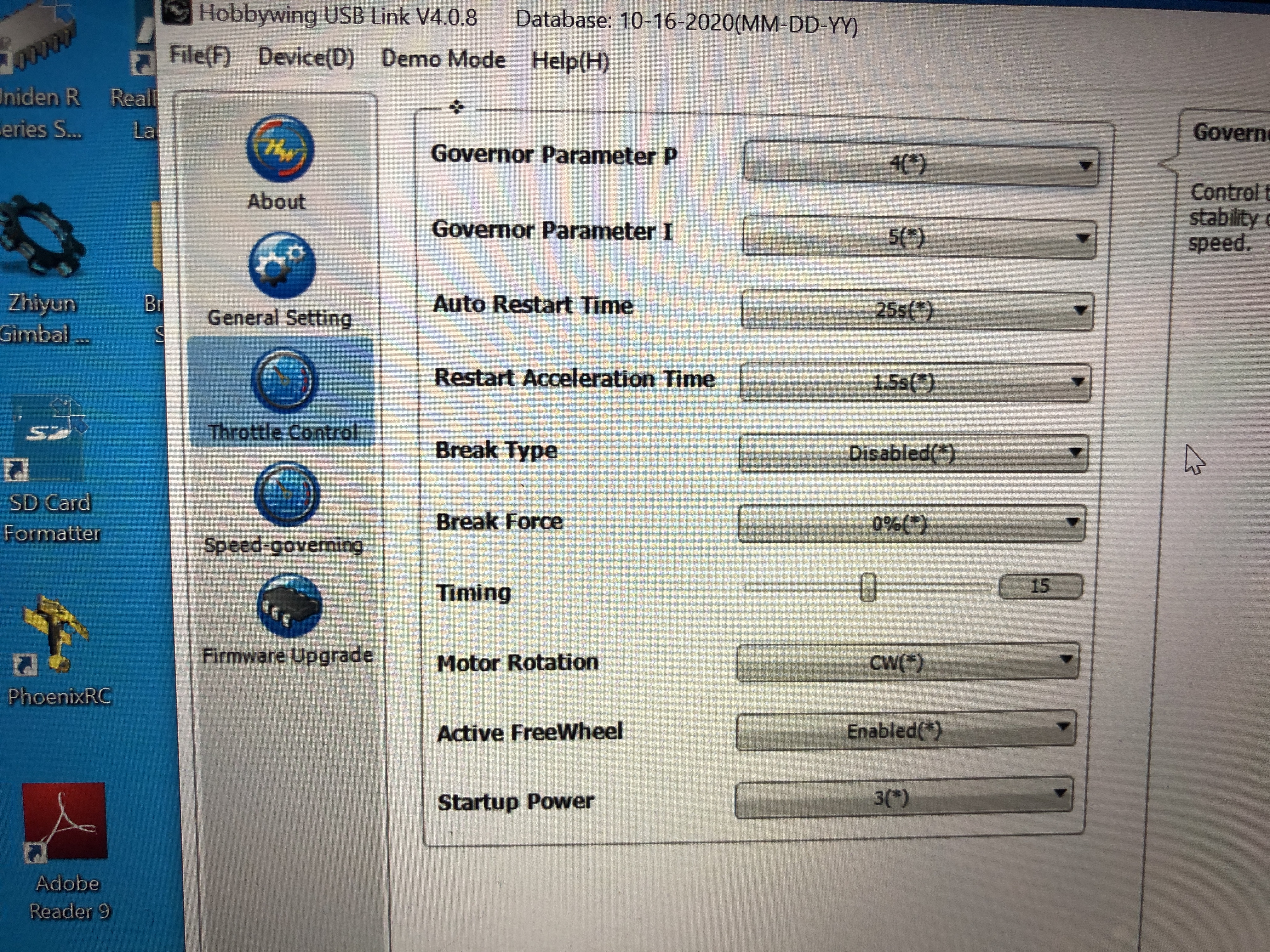

I am having rpm issues. I'm running flat 45 curves (normal) and the motor starts correctly and then looses power and starts up again. It starts to spool up and then looses power and drops.
Video of rpm issues:
https://youtu.be/tKjE9mH56IM
ESC setup see 2 pics
IMG 3293
IMG 3294
(@claude-canna)
ok i fixed by un check the use gov in Brain2 page 13... thoughts?
