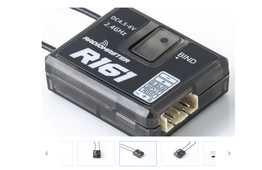

Can I use this receiver and connect for telemetry, my frsky R-XSR was connected via sat port but the soldered wire has pulled the pad of the receiver, I don't mind ordering another R-XSR but not so keen to solder the wire back on.

Yes, if you search "R161" you can find this thread:
ikon2-bt-r161-receiver-telemetry-help
At the end of the thread, in the last post you can find also a link to a video for R161 "F.Port" firmware flashing, connecting and configuration.

Or, you could read this other post:
r-xsr-f-port-brain-2-telemetry
and load the ACCST 2.1.1 firmware version "RXSR_ACCST_2.1.1_Fport" into the R-XSR receiver and connect the S.Port output (that works in F.Port mode) to the CH3 of the flight controller where you will have selected the "F.Port INVERTED" protocol icon.
(Your Radiomaster transmitter don't work with ACCESS protocol for now).
