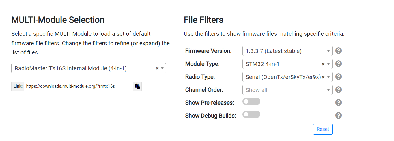

My transmitter module is indeed older but the latest version of Radiomaster internal module is 1.3.3.7. What do you mean with 2.2.1?

Updating the internal multi protocol module to 1.3.3.7 seems to have fixed the speed problem. thanks for the help.

The suggestion we made to upgrade the internal ISRM RF module to 2.2.1 was for FrSky radios. You rightly upgraded the internal RF module of your RadioMaster transmitter which is a different multi-protocol module.
