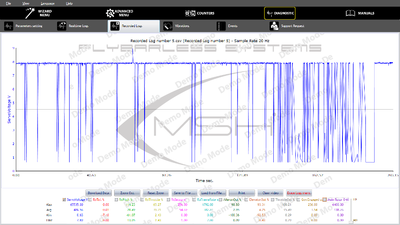

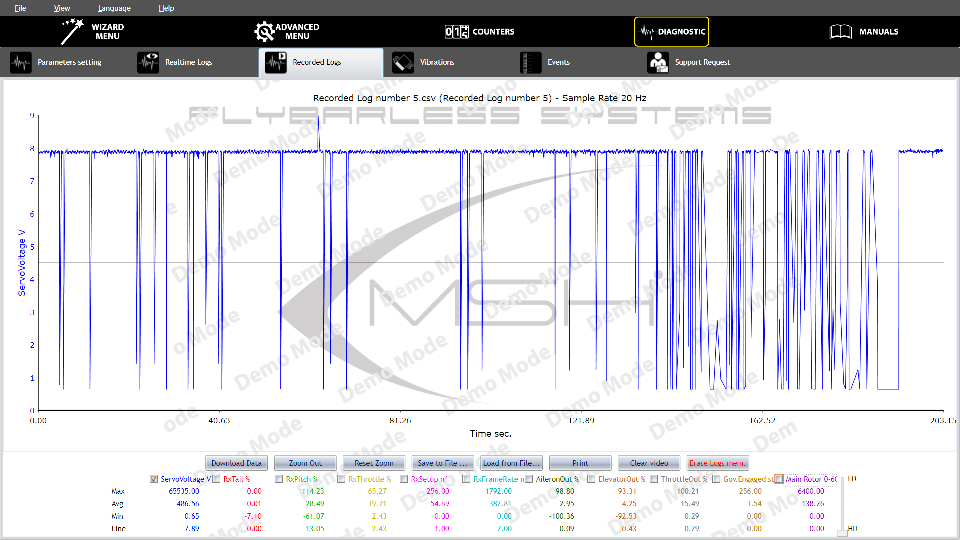

In the submitted log, numerous momentary power failures of the receiver, servos, and controller are visible. This could be caused by the Recorded Log memory being fouled during a firmware update and not reformatted immediately after the update (we suggest re-initializing and formatting the logs memory anyway using the red "Erase Logs Mem." button).

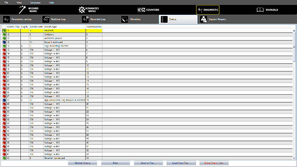

However, there are also visible in the Events numerous red #156 "Voltage <= 4V3" events that should never be present because they can cause malfunctions or even resets of the receivers, servos and controllers and that confirm what we see relative to the "Servo Voltage" curve in the Flight Log graph.
So as the first and most important thing you need to understand what these severe power sags/disruptions are depending on.
Check the crimping of the BEC connector leads and that the connector is inserted all the way in and does not move due to model vibration (stop with hot glue). If the ESC has an auxiliary BEC output make sure it is connected. Verify that no wires may be momentarily shorting to an edge of the carbon chassis against which it may have stripped.
This intermittent power supply could be the cause of the motor restarting.

thank you for review, that power fluctuation was the servos going nuts during log download.
the 4.3v is usb power not bec
i believe both these issues were called out in the latest release. (which i have updated to)

Side note: 4.3V is not the 3.4V of the Events. When the flight control unit is powered from the USB connector, there is no voltage on the "Servo Bus" (front connectors). Therefore, it is impossible for the servos to move causing drawdowns of the USB supply voltage.
