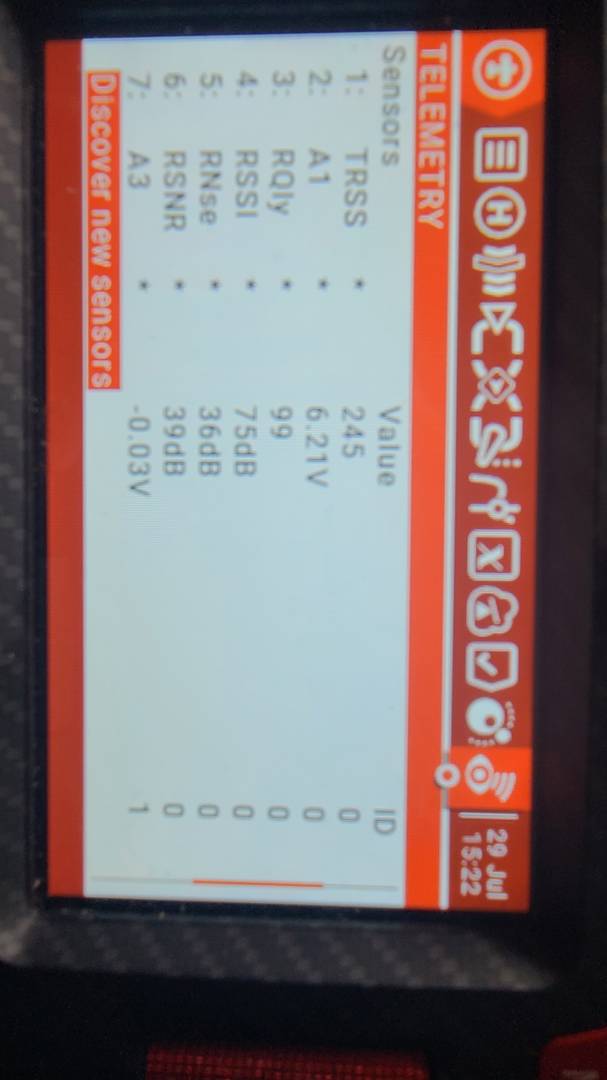

not getting the telemetry sensors in hobbywing platinum 40amp esc with brain2 latest firmware on both. using an Sbus connection

I don't have any files since this is not a flying issue. I have the white wire connected in port 6 on the Brain to the esc. (also tried port 5 and 4 but per the documentation, it says this setup should use number 6) I opened the diag area in the application via phone (BT version) and selected esc voltage. When I discover sensors, I get only the attached as shown.
sensors

Without having received the configuration file of the flight control unit either, we cannot be of much help.
However, since we have received the receiver model, we can try to clarify this for you:
The S.Bus serial protocol with which your receiver communicates with our control unit is a unidirectional protocol that only transports the values of the various radio channels from the receiver to the control unit but is not supposed to transport any telemetry data from the control unit to the receiver (Futaba's S.Bus2 protocol does this but is not used by any type of receiver for OpenTX radio systems).
The documentation of your TGY IA6B receiver does not mention any telemetry protocol and therefore you will NEVER be able to receive any telemetry on your OpenTX transmitter using that receiver model.
Receivers used with OpenTX systems (FrSky, Radiomaster, etc.) use only the following three types of protocols for telemetry data transmission: Smart.Bus, F.Bus, F.Bus2.
So you have to find a receiver compatible with your transmitter that uses any of these three protocols.
As far as the USB cable is concerned, you are almost certainly using a USB cable for phone charging only that does not contain wires for data transfer. Try another USB cable.
