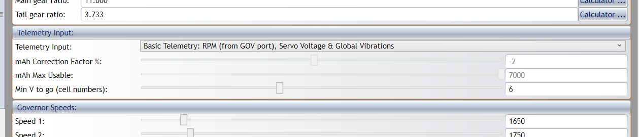

About the swashplate movement of the elevator and the motor not starting until the third attempt, it is caused by the value set in the parameter "Min V to go" set on the voltage value of six cells to be checked, but with the ESC telemetry not active and therefore not able to read the voltage of the Lipo pack. Read the instructions in the balloon that appears by hovering the mouse over this parameter and set the value to 1.
