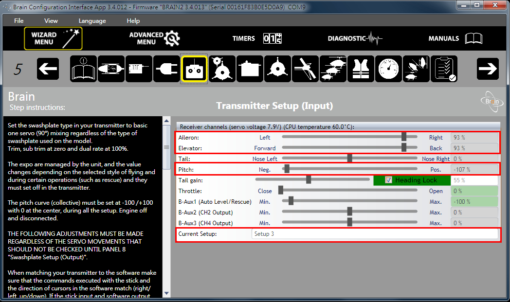

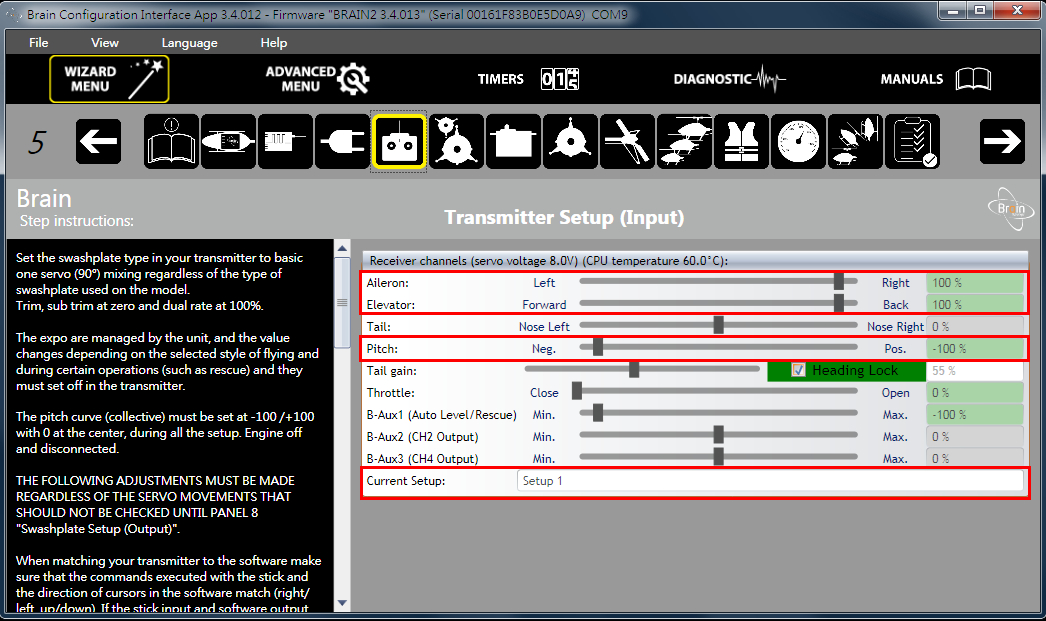

I encountered a situation, when i changed exponential value in the Brain2(ail, ele, tail(rud), pitch), any of these, the receiver channel output value in Brain2 will be change?
Example 1:
When i changed aileron exponential value (0 ->10) in the Brain2, the receiver aileron channel output in the Brain2 will be changed (-100 -> -93, 100 -> 93).
Example 2:
When i changed pitch exponential value (0 -> -20) in the Brain2, the receiver pitch channel output in the Brain2 will be changed (-100 -> -107, 100 -> 107).

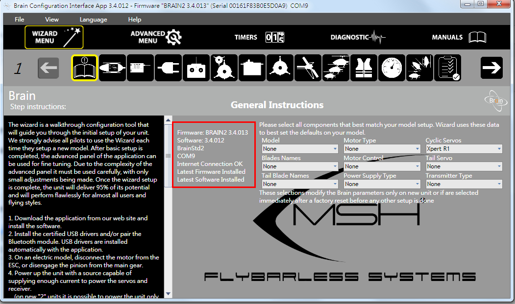

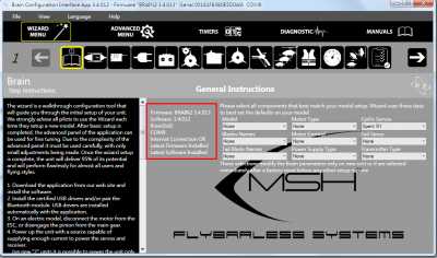

I just confirmed that my Brain2 firmware was 3.4.013, but the PC software is 3.4.012.
The bug not fixed.

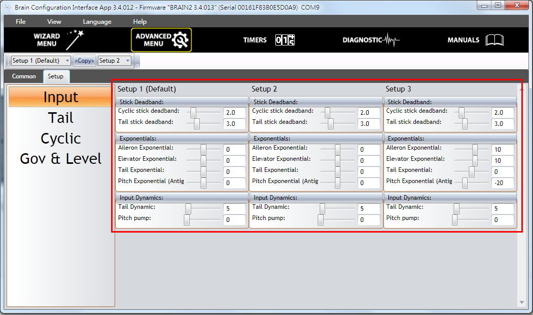

The configuration file has been uploaded, please help me to judge this is my setting problem or the others problem, thank you.

Regarding exponentials, as already explained this has been already solved and approved by beta testers but before releasing the new firmware we need to finish the work in progress on other features.
In the meantime, and for now, the exponential problem can be easily solved in many ways:
a) If you use the same value of exponentials on all three setups just change the ATVs of the transmitter to get -100% +100% excursions.
b) If you use different values of exponentials, you can reset the exponentials on the flight control unit and use the exponentials on the transmitter.
c) You can downgrade the firmware to version 3.4.000.
d) If the excursions do not reach exactly the +100% or -100% values but the numerical value fields still remain green, the control units still work correctly and without problems (so, you can use a "medium" value for ATV that stay in green area).
