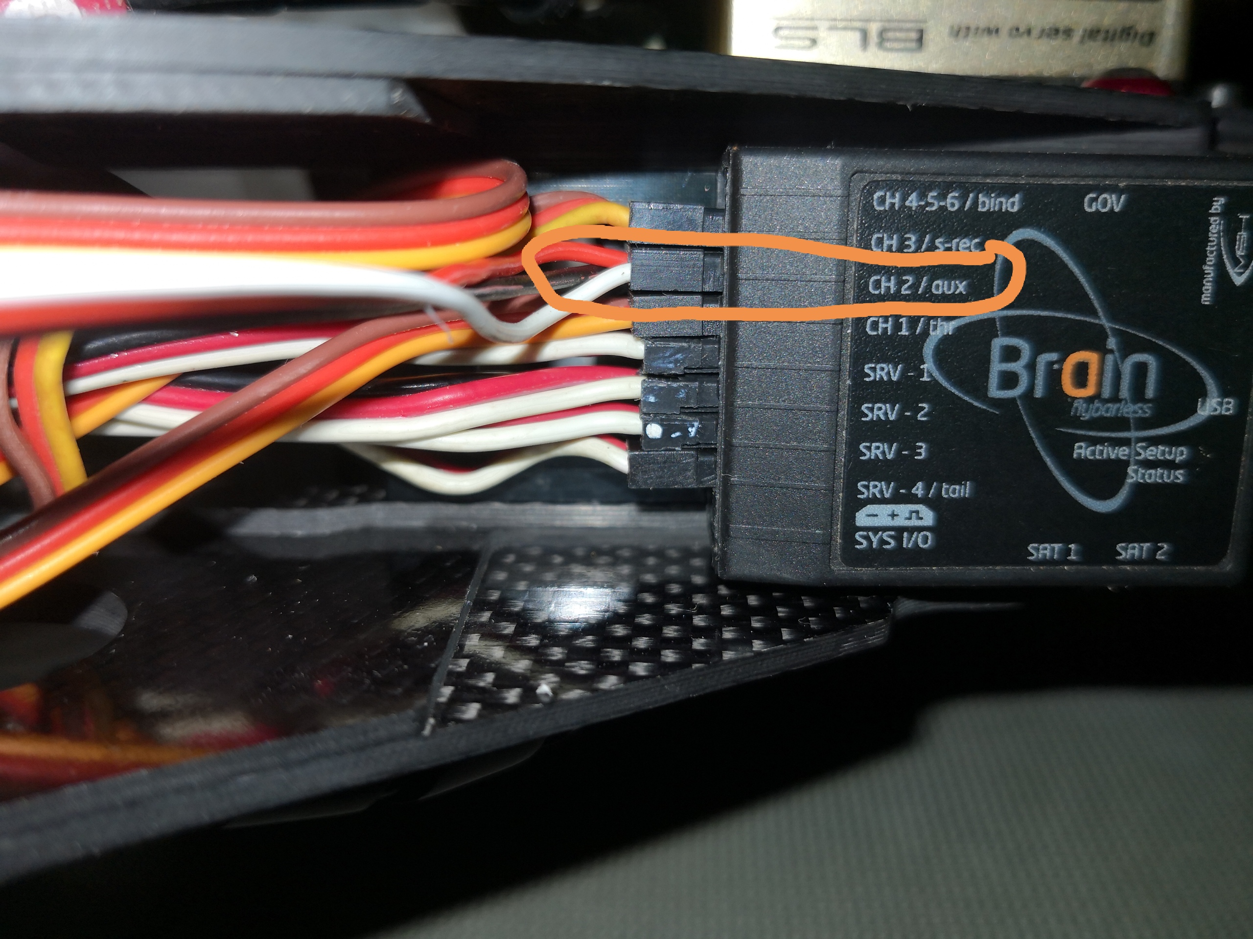

(@rotems)
Hello,
Problem solved!
I've connected the receiver to CH2 insted of CH3.
Thank you very much for your support.
Rotem
IMG 20191027 235945
All is well that ends well!
(although it is not clear from the picture what was connected to CH3/S.rec).
