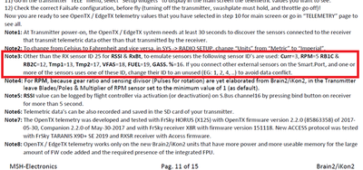

For all these reasons, we strongly advise against making a manual setting of the sensors, but to have it done automatically by the transmitter.
Regardless of the above, the telemetry documentation contains references to the IDs you are asking for:
