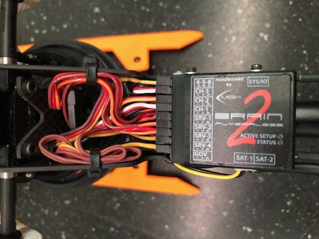

My Brain is mounted like this:
IMG 6647

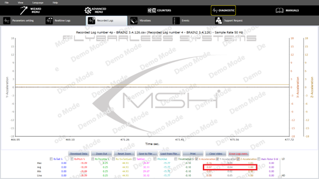

From the vibration graphs, it is interesting to note that the highest amplitude vibrations are not those at the fundamental frequencies (Main Rotor, Tail Rotor, Motor) but instead seem to be at the harmonic frequencies of the fundamental frequencies especially that of the main rotor.
Are you sure that the tracking is calibrated correctly and that cannot unregulated in flight due to a crooked spindle rotating at each pitch change?
Have you tried setting the Global Vibrations value among the parameters to be logged?
Since the loggable parameter "Global Vibrations" is calculated internally by the FCU firmware while the Global Vibrations value in the "Vibrations" graph tab is instead calculated by the software based on the vibration graph curves, it would be interesting to see if the two values are similar or if there are significant differences.
The other interesting values to check are the signal amplitudes of the three accelerometers X, Y and Z. By zooming in on log 4p (what is the difference between log 4 and log 4p?) where it can be seen that the model is now landed and stationary on the skids, the average values of the X and Y accelerometers turn out to be at 0.007g and 0.04g and these are normal values caused by very small lateral and longitudinal tilts of the model when it was stationary and resting on the skids, and the average value of the vertical accelerometer Z corresponds to 1.00g which is the correct value of the Earth's gravity acceleration:
So there do not seem to be any errors in the correct readings of Earth's acceleration by the three accelerometers, and this is good news that already allows us to be able to rule out many possible types of problems.
Finally, we noticed that both you and the HeliFreak user who has the problem are using the latest firmware 3.4.126 released on July 19, 2023. Since the problem over the twenty months (now 21) since we started using the new chip has only begun to be reported in the last month and a half, it raises the question that it could be caused by the changes introduced in the latest firmware. Have you tried loading an earlier firmware into the FCU such as, say, 3.4.122 or 3.4.116 or 3.4.103 or 3.4.094 or 3.4.059 to see if other changes may have unintentionally affected the calculation of the vibration graphs?
That's right, these were my observations too. And I wondered if they came from the tail servo (21k RPM is close to 333 Hz) but definitely not, because they follow the main rpm.
I hope so - I spent a lot of time on it. The spindel is straight; I verified this by rotating it and checking whether the distance of the blade from the tail boom doesn't change.
I had some issues with the main hub, but after corrections I didn't notice any improvement in the logs.
Pls keep in mind that last two logs (21 and 23) were collected with a different, not original tape.
Oh, ok, now I get it! I didn't catch the difference between "Vibrations graph / Global Vibrations" as a fixed "Log Parameter 12" and selectable "Global Vibrations".
Sure - I can add it to the list.
I found somewere information that it is good to "erase all logs" after modifying logged parameters. I didn't know that this would also reset logs numbering. So at some point I had duplicated names.
BTW, this might be a good candidate for improvement - to avoid resetting the log numbering. The log number could be the same as "Main Flight Count".

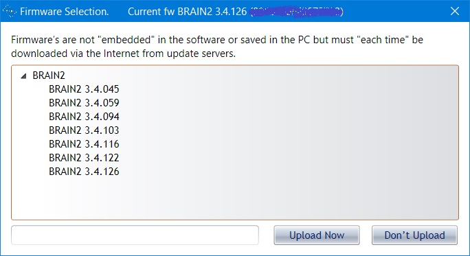

Nope, I havn't. But I can try. AFIK FW downgrade has to be done manually. So please share the relevant binary and I will try to apply it.

The double-sided tapes used in RC modeling are not made of random materials like those found in hardware stores but use materials that absorb well-determined frequencies with well-determined attenuation factors. In tests done by us and our Beta Testers, the double-sided tapes that best filter the vibrations of our Eli RC combustion-powered (Nitro/Gasser/Turbine) Eli are the Nitto, Sekisui and Futaba ones, but they are not found at all RC modeling stores. Using double-sided tape sold in hardware stores can make filtering much worse as you yourself noted by using one not specifically made for RC modeling.
Ok.
Posted by: @kudzu-mse
The numbering of Recorded Logs cannot be related in any way to the Main Flight Count because sometimes it can also be useful to make Recorded Logs not in flight but on the workbench during setups and in this case the Main Flight Count does not advance. However, the number of Recorded Logs is shown in the Events which can then easily be correlated with each other as well as the vibration graphs where the seconds shown correspond to the seconds shown in the recorded logs graphs and you can see how the vibrations are correlated to the commands given in flight to the model.
It is impossible that you have never updated the Firmware.
When you update the firmware, you will have seen that the window appears for selecting available firmware that can be written to the flight controllers.
When it is an automatic update, the bottom box already automatically proposes the new / latest Firmware to be written into the flight controller and you only need to press the "Upload Now" button.
On the other hand, when you manually update the sign using the "Manual Firmware Upload ..." command found in the "File" menu (top left), you can select the firmware line you want to write into the control unit and then press the "Upload Now" button.
Nothing could be simpler.
