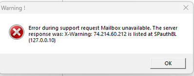

The online submission in the software doesn't appear to be working.

Good morning,
Thank you for sending the screenshot of the error, this allows us to improve.
The sending of the email fails because the address 74.214.60.212 (located in Mariland in USA) turns out to be blacklisted on SPauthBL which is in localhost (127.0.0.X).
Since it is in localhost, it is most likely the PC's antivirus that is blocking the sending.
We therefore suggest that you turn off the Antivirus & Firewall for a moment and try the send again.
