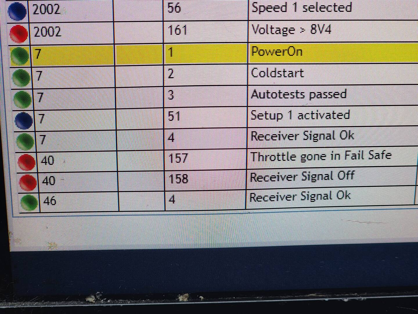

(@brentellis2)
Joined: 3 years ago
Hello, I was able to reproduce this issue on the bench as well.
Brain2 went into failsafe when testing with FrSky X20
Using FrSky RS receiver on v2.1.10
X20s is on the latest firmware
Hobbywing Platinum v4 120a
Prior to the event I noticed a "sensor lost" audio alert and "Fuel" telemetry was lost.
About 30 seconds later Brain2 reported "Throttle Gone failsafe" and then reported "Receiver Signal Off"
When this occurred the FrSky radio also lost all ESC telemetry but receiver telemetry remained.
Can't seem to access my original MSH account and can't upload files on my new account so here is a google drive link to my config, logs and telemetry screenshot during the event.
drive(dot)google(dot)com/file/d/1cQD08MxBle44bP-3dmH2uq-EuMYrAFw1/view?usp=sharing
Happy to provide anything else if needed.
