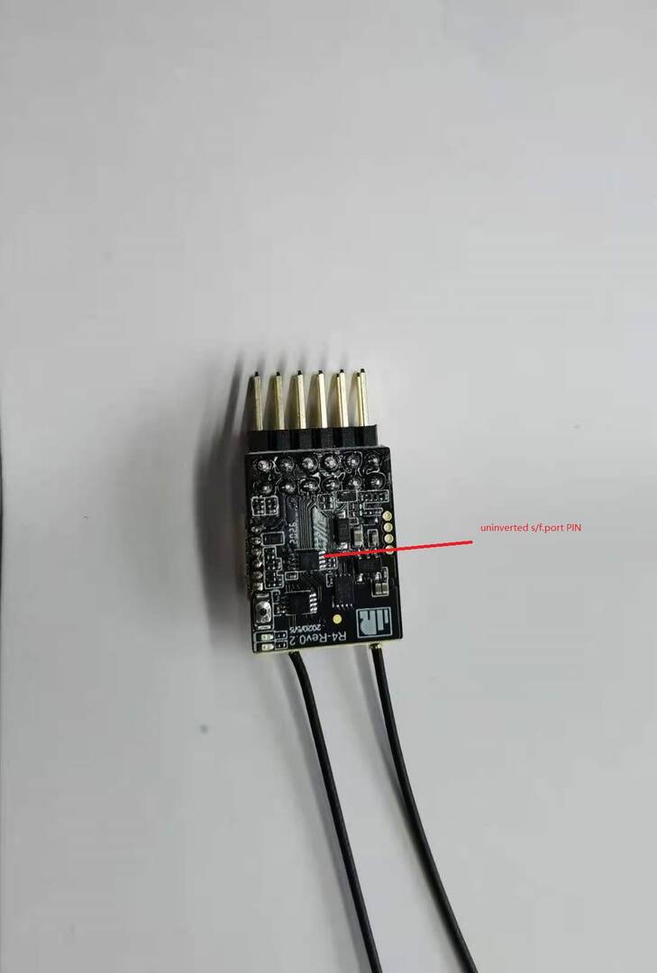

(@maciej-j-wnuk)
Posts: 50
Posted by: @flyerfry
I have the same question. I have a FrSky Archer R6 and have been unsuccessful at getting the F.Port protocol to work with my Brain2.
Below you'll find a location of uninverted s.port pin on R4 receiver. I don't have the same guide for R6 but I suppose it will look very similar.
78bd413e4c8dff96d642e5f9605a11b (1)
The leg is IMO too small to solder it properly and to do it in a safe manner. I wouldn't trust this solution. I guess the RS is the only solution for now.
Posted by: @maciej-j-wnuk
Thanks for the input. I know RS has ready output and works well (I guess I'm the one who gave you the hint on FB to use RS for testing purposes)
But this doesn't really answer my question.
If your question is:
"But, if the Brain2 can accept inverted signals on CH3, such as S.Bus and bi-directional S.Port, why can't it accept inverted F.Port signal? Is it some kind of physical/hardware limitation?"
The (short) answer is:
Not possible.
Yes there are limitations.
I suggest to contact FrSky that when I raised the question and put my doubts, he sent me a wiring diagram of how to build an expensive bidirectional inverter, asking him when they will produce in China at high volumes and then at low price the accessory "bidirectional inverter" for all their new Archer receivers.
