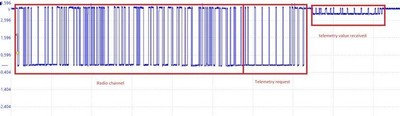

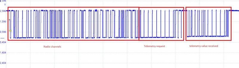

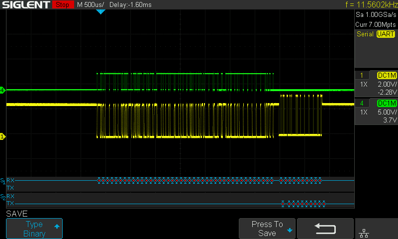

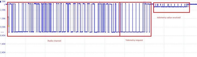

From a purely technical point of view, the problem with F.Port is that the receiver's port immediately after sending the request packets to the sensors should immediately listen (go into input mode) to receive the answers of the questioned sensors from the bus as it happens with X4R receivers:
F.Port X4R
Instead in XSR receivers the port remains in output mode, so the signal sent by the sensors to the receiver is not read by the receiver and is physically clamped:
Fport XSR

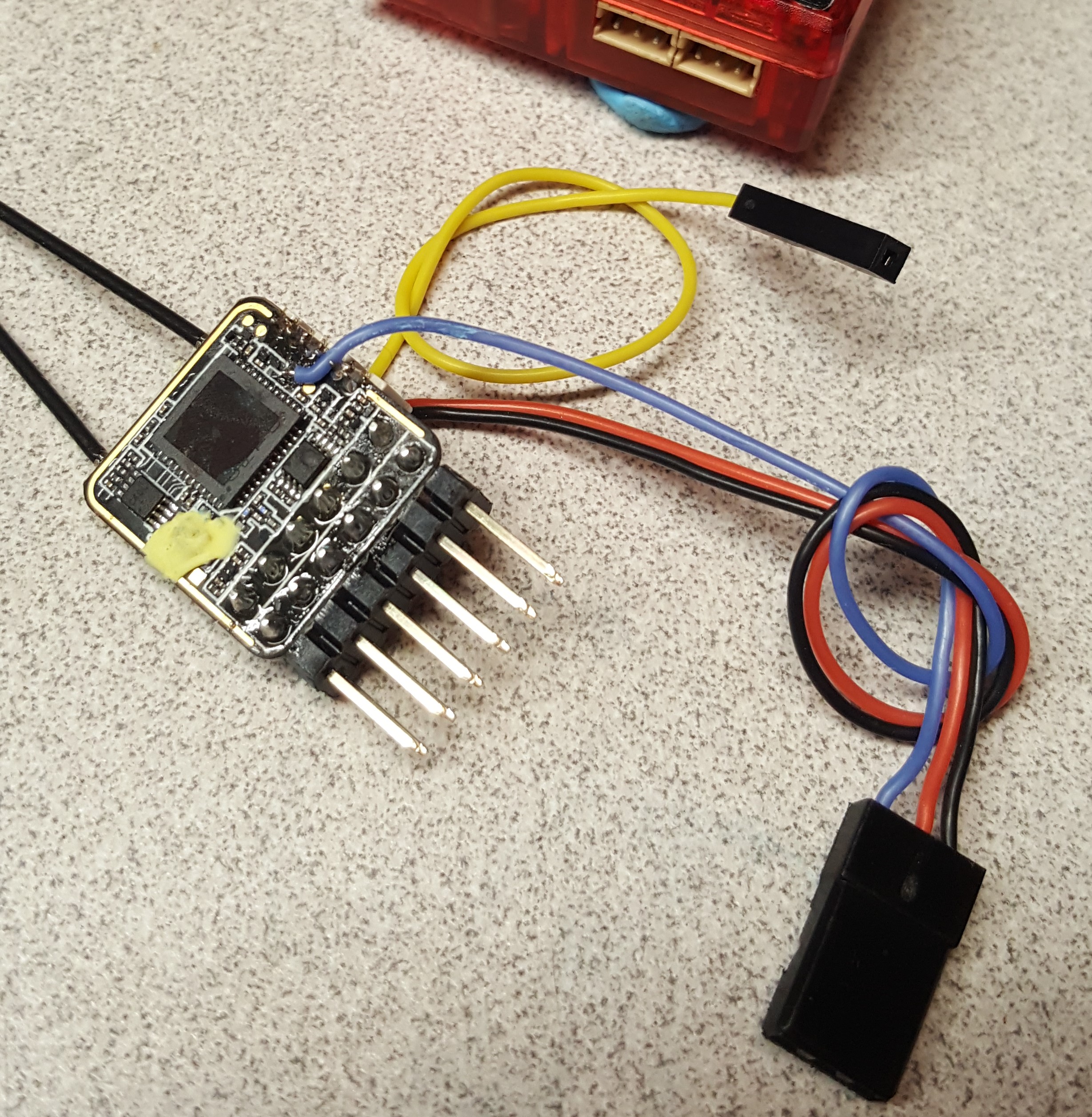

I had already tried wiring-up the inverted S.Port on the RXSR, without success.  After reading this, I decided to try the same thing with an RX4R.  It works!
On the back of the RX4R there's an oval-shaped solder pad.  I soldered one of the spare wires to that pad and swapped it into the servo connector shell.
