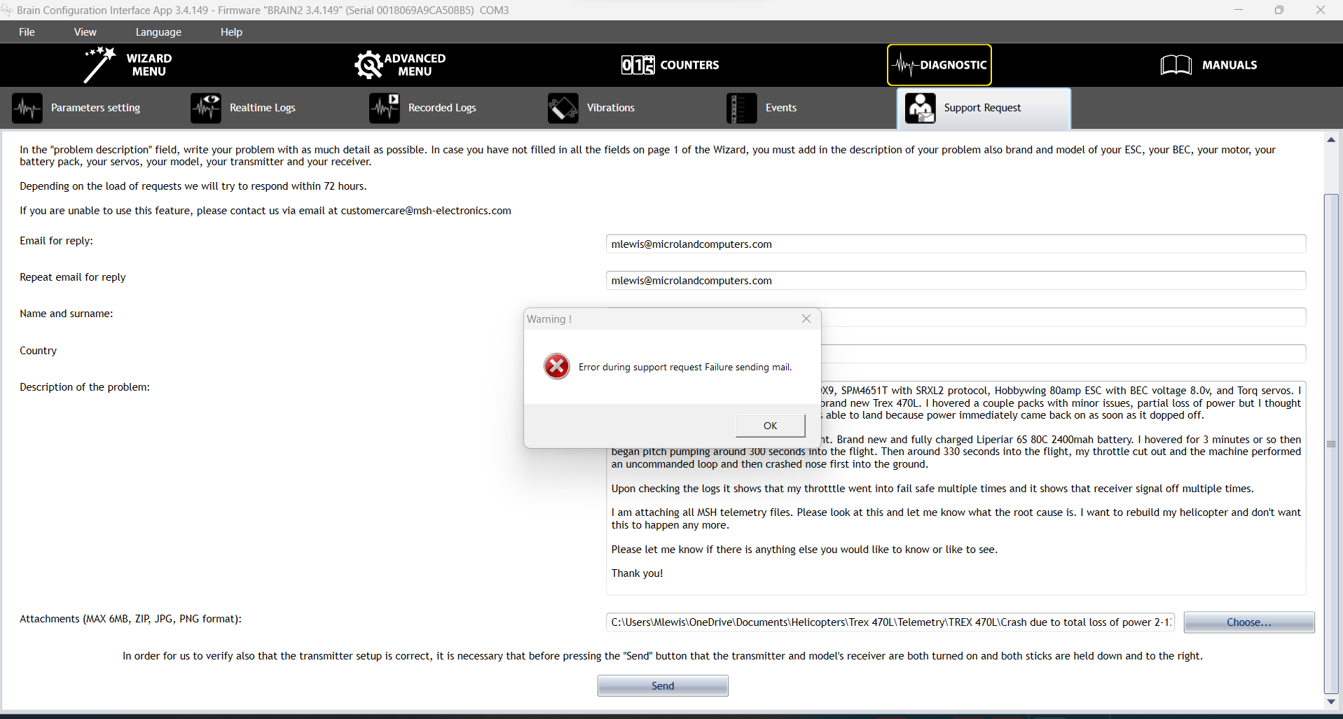

@customercare Hi! I tried to open a support ticket using the Brain software as indicated in the instructions. However I receive this error message:
Also the system here will not allow me to attach any more files. I will post a link instead to my personal Onedrive:

To understand why you are unable to send us e-mail through support requests, it would be helpful to know whether you have an active and stable Internet connection, what kind of antivirus you use, and whether you have tried before sending the support request or attaching files to temporarily disable your antivirus and firewall.
Have you tried sending us an e-mail with files attached to "customercare@msh-electronics.com" yet?
