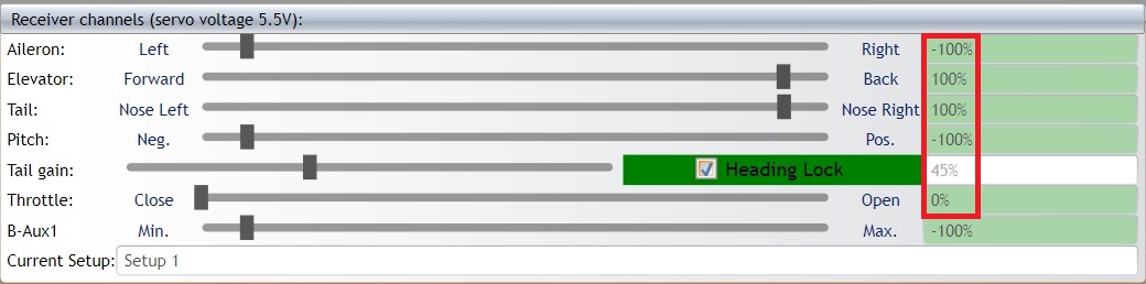

Check in the transmitter telemetry setup of your tranmitter that "Text Gen" is active. We do not have a DX8e to be able to make checks but in the iX12 "text Gen" was recognized and saved together with the other temeletric parameters but it was not activated and had to be activated manually (and then save the change).
Also verifies that the ATVs of the channels were not moved / changed.
Going to panel 5 of the software, you will see the following values +100% or -100% or 0% in the respective channels as in this image:

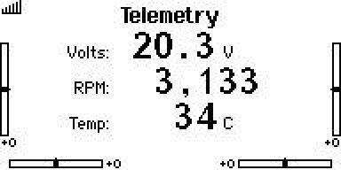

The strange thing is that in the Airware 2.06 a new "Priority Monitor" page has been added to the telemettry pages where it is clearly visible that our Brain2 controllers are regularly transmitting the "Text Gen" data but the page don't "... appear automatically on list of roller screens":
However, it is strange the inconsistency that the Priority Monitor page displays only 7 sensors, when the telemetry setup page allows to manage up to eleven sensors (and Brain2 with some ESC types uses all 11 sensors).
In addition to this we also noticed that with "Auto Config" all sensors emulated and transmitted by Brain2 controllers are no longer recognized. For example RPM, Volt, Temperature sensors are not found even if they are regularly transmitted and recognized by the previous version of Airware. With version 2.06 you have to insert them manually in the free slots.
We have already reported problems to the Spectrum developers and are waiting for an answer. In the meantime stay with version 2.05 of Airware and do not update to the new version.

In addition, "Auto Config" no longer recognizes and no longer automatically activates the sensors:
- RPM
- Voltage
- Temperatures
Which must be added manually (remember for the RPM sensor to set 10 in the sensor reduction ratio) in order to display this page as well:
