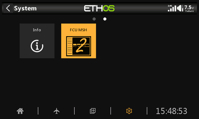

With Ethos unlike OpenTX there are two types of applications and some cannot be run by selecting the file directly, but are preloaded in memory and run each time the transmitter is turned on.
In order to have them loaded and run when the transmitter is turned on and then be able to switch to their display, you have to do exactly as explained in the Readme.txt file and then select their icon displayed in the "SYS" section:

I am running 1.3.3 on the X18S and what I found in the general setup page was that the script will not run if the scripts are set to "radio".  I turned the selector to "SD card", moved the scripts folder to the SD card and it runs.  Perhaps something changed with newer Ethos software.
