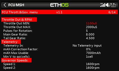

Good morning Keith,
Have you had a chance to try the new version 1.1 of the LUA app for Ethos yet to see if it now works also with external radio module?
We could not add the specific commands to enable telemetry communication with either the internal radio module or the external radio module since the LUA interpreter does not have a command to be able to recognize from the settings which radio module has been activated and used by the users, but we have removed commands that might limit the LUA app to work with only the internal radio module.
Since we don't have the Twin module to be able to test this, we would like to know.
