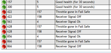

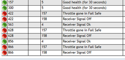

@customercare im sending my configuration file and log from connecting and disconnecting SENS port after successful initialization. Red dot shows when i plug Y to SENS port and then brain frozes, green dot shows up when i plug off Y cable from SENS port
