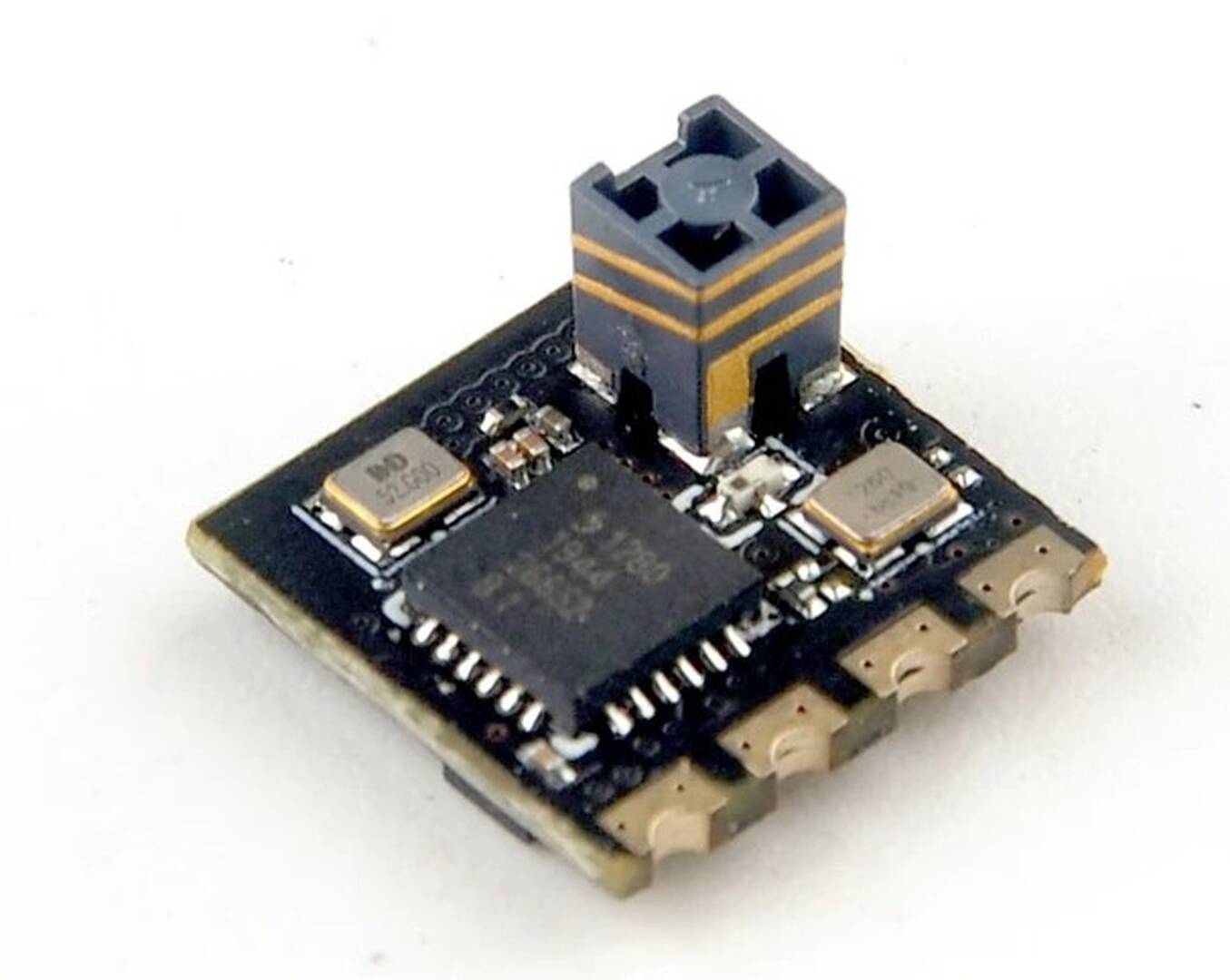

I'll put in a soft request for crsf (crossfire) support.
I'm flying expresslrs on a quads/planes with flight controllers and would like to use it on helis.
I'm interested in flying/using the tiny rx's with tiny antennas on my heli.
thanks
